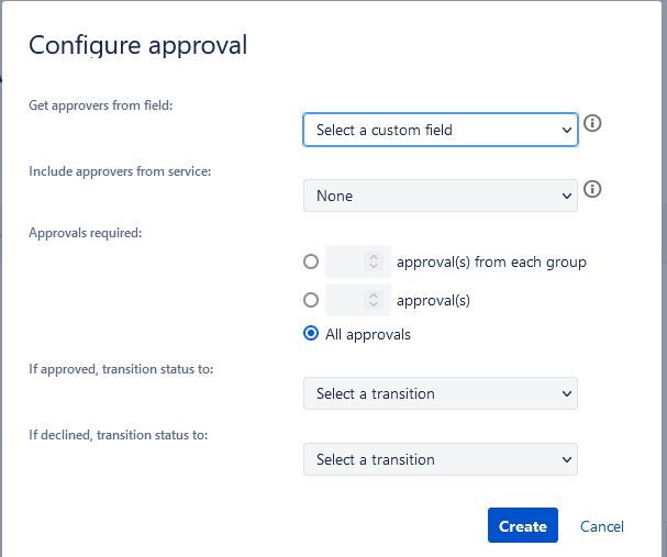

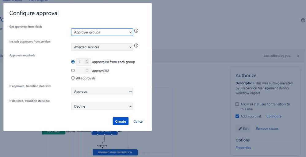

My understanding of the problem statement, you wish to set up a 2-step approval process for Service and Change requests. After the 1st approval, the approvers are rest and is blank which you want to set up.
If this understanding is correct, then this can be accomplished by setting up the Approvals appropriately. The Approvals can be set to select from the Group field which can contain more than 1 Group and then define it obtains 1 approval from each group.
Also, if you need the SR or CR to go to the 2nd Level Approver only when it has been approved by Level 1, you would need to have separate status in the workflow.
Please refer to the below screenshot.
Kindly accept the answer if this helps.
