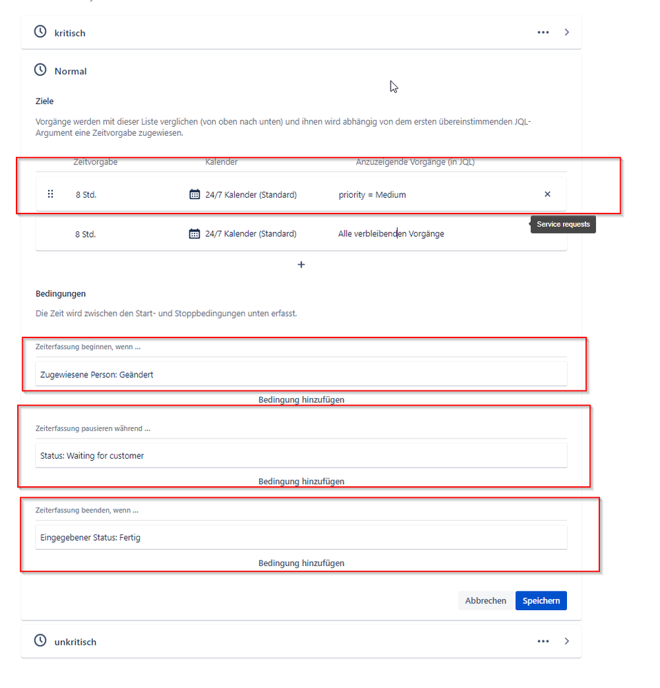

So i am still facing some Issues, i tried to make the changes simple, once in the ticket if i open it and we dont change the tickets into incidents or something else, we just leave them as : Email requests.
So i created the SLA's according to this:ticketcreation.png
the problem i am facing as you see the only "X" option to get rid of the 8h with the JQL "Alle verbleibende Vorgänge" menas, all remaining issues, cant be deleted. How come i can't delete that?
then further down in the conditions tabs i say, the time should start once a Agent assigns the ticket to someone.
The waiting time starts once changed to waiting for customer and the time ends, once the Status is changed to "Fertig" which is Finish.
So for the conditions i think it should be fine, and also for the JQL uptop (redcorner) i think it should be fine.
When i create a ticket and change the priority to Medium (see picture)
It still shows me all 3 SLA ( i think this is because of the all remaining issues field that i can't delete?
Or why do i still have all 3 SLA's shown inside the ticket ?

Gaurav
July 23, 2021
Hello @Cedrik Keviczky
The SLAs work in a sequential manner. When a ticket is created, the system compares it to the defined SLAs aand assigns the one which matches the JQL.
So to cater to issues which do not match any condition, we have the SLA for 'All remaining issues'.
You can update the goal for this to 'No Target', which would keep the system for tracking the tickets which do not match your JQL conditions.
Also, you might have a case of using multiple Priority (like I am :) , refer the screen shot). If that is the case, we need to be careful while defining the SLA rules to ensure that we are referring to the correct priority (or JQL condition).
Once we have this streamlined, it reflects as Response and Resolution SLA on the ticket which keeps counting down. Please refer the screenshot.
Kindly let me know if this helps or if you have any other questions.
