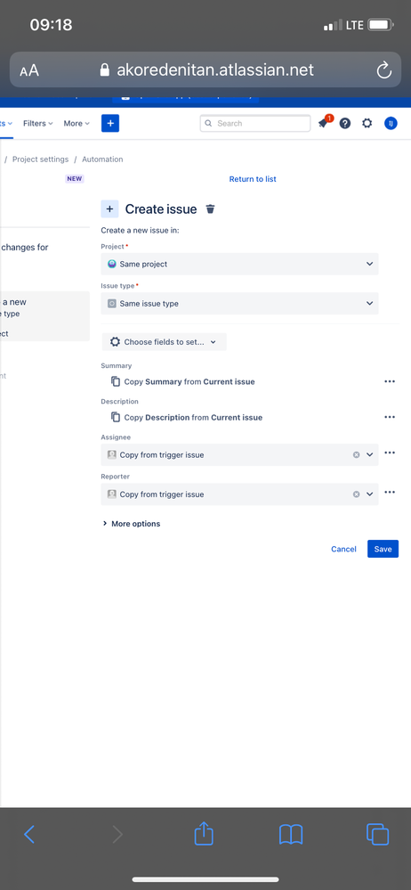

Ismael Jimoh
January 17, 2022
You set it to copy from trigger issue.

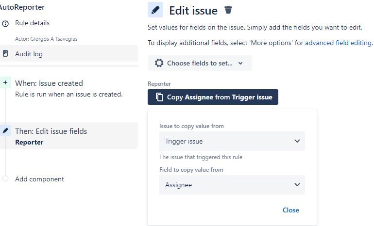

Giorgos A Tsavegias
January 17, 2022
@Ismael Jimoh
Created the one below but i am not sure if it is correct. The point is that it is not executed.
Ismael Jimoh
January 17, 2022
Yes that should fulfil your requirement.
