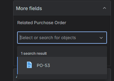

I'm starting to wonder if it is even possible? Since the field is using this + sign

And this is how I want it to look:
https://imgur.com/a/cney3Cu
