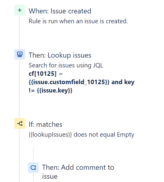

yes, you can achieve something like this with Automation.
I thought of an automation like this:
  • When: Issue Created
  • Then: Lookup issues
    • You can specify a JQL then to look for the issues, you're interested in. If you're value is stored in the custom field 11127, you could use a JQL like this:
      cf[11127] ~ {{issue.customfield_11127}} and key != {{issue.key}}
  • And: Add comment to issue
    • In the comment, you can use {{lookupIssues}} in order to include your result.
      You could probably modify that with an if condition that the comment is only written if there actually are some issues.
For more details, I'd recommend to check out the docs about smart values or the lookupIssues function.
I hope that helps,
Matthias.

Johannes Nyberg
July 7, 2022
As you mentioned it is possible to add an if-statement to make sure that the comment is only done when the list is not equal to empty.
Like Matthias Gaiser _K15t_ likes this
