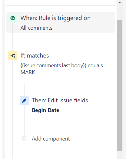

Jira seems not to pick up or read comments added by email
How to replicate it:
  • Create an automation to check for "mark" when a comment is added
    • Run Trigger on comments
    • if {{issue.comments.last.body}} contains MY_MARK
    • do action e.g. change value or something
  • Send via email a comment to the Ticket ID
The trigger will simply not fire as it seems the comment is not to recognized by automation/system
Has anyone had this same issue? Is it per design or probably it is a bug?

What does the audit log show? You mentioned it doesn't work for emailed comments, did you try adding a comment via app/portal? If so did the Automation run successfully? Finally, can you add an action log ... "comment = {{issue.comments.last.body}}".

  • If I add the comment via portal the automation does work.
  • Should I send an email comment, the automation does not show anything, only the last CONFIG CHANGE time
I did put a trap similar to what you described, it still does not return anything.
To make this automation work, I have used a Cron Job that fires every 5 minutes and reads for comments bearing my KEY_WORD and run the change.
