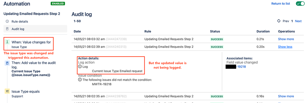

Automation "B" has a trigger of Issue Type Updated. I see the issue from Automation "A" hitting the trigger telling me that the issue type change has been logged. However, the condition to validate that issue type is set to Type 2 fails.

I have several thoughts on what you're experiencing.
  • Your first screenshot confuses me a little. The Audit Log shows a "Re-fetch issue data" step, but I don't see that in the Rule Details in the left margin.

Thank you for your ideas! Sorry for the confusing screenshot, I had considered removing the refetch and what you are seeing is it removed from the rule but I never published that change. Here is what it looks like:
So, the re-fetch is part of the automation. The "slow to respond" is coming from the first action of editing the issue type. The screenshot of Step 1 shows that the audit log entry after the re-fetch still shows the original issue type.

I had previously tried this as one automation with a refetch between actions/conditions and found that the refetch was still showing original values and the conditions were failing. That is why I separated the automations hoping that the action of the first automation will successfully trigger the second (it did!) and pass the necessary conditions (i didn't).
