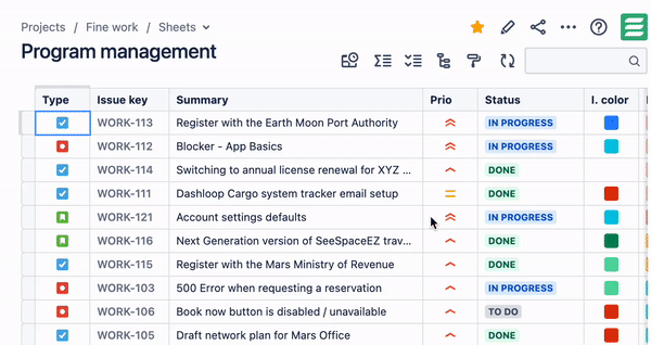

if you're open to solutions from the Atlassian Marketplace, you may want to have a look at the app that my team and I are working on, JXL for Jira.
JXL is a full-fledged spreadsheet/table view for your issues that allows viewing, inline-editing, sorting, and filtering by all your issue fields, much like you’d do in e.g. Excel or Google Sheets. It also comes with a range of advanced features, including support for (configurable) issue hierarchies, issue grouping by any issue field(s), sum-ups, or conditional formatting.
This is how it looks in action:
As you can see above, a JXL sheet can give you pretty much anything that a queue can give you, and much more. Plus, it works with issues and projects of any type, be it business, software, or service management projects.
Best,
Hannes
Hi @Hannes Obweger - JXL for Jira ,
Thanks, that looks exactly like the solution I am envisioning.
Will definitely look into it.
