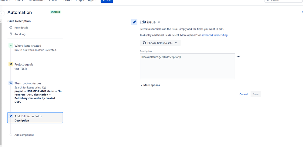

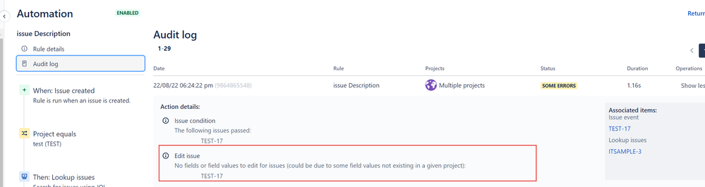

Baris August 22, 2022
Hi Mark,
I've changed the value
{{triggerIssue.description}}
But it is still not copying  the issue description from the JQL that is in the automation
Mark Segall
August 22, 2022
Sorry - I didn't catch a couple things with my first response.
After reviewing the rule a little closer, I see that you're trying to trigger on the target.  My mistake as I assumed you were cloning from the originating issue.  In this case, you'll want to make the following changes:
  1. Remove the branch.  You're already in the current issue so you don't need that
  2. Assuming your lookup issues action is looking for the source issue that you're trying to grab the description from, you would want to change your smart value to this:
    1. {{lookupIssues.description}}

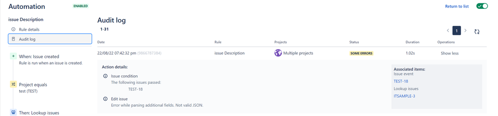

  1. I removed the branch as you suggested.
  2. Yes the lookup issues is for the source issue. And I want to grab the description of that issue.
  3. I have changed the value but it says not a valid json.
Mark Segall
August 22, 2022
Let's make a slight tweak:
{{lookupIssues.get(0).description}}
The invalid JSON is likely because Lookup Issues is returning an array.  This change will bring in the description for the first issue in the result set.  I'm assuming your query will always bring in only one issue so this should cover that need.
bmccoy
August 22, 2022
Hi
I also noticed you are adding the details in the "Additional fields sections" - this expects a fully qualified Jira edit payload.  Instead, open "choose fields to set" dropdown and select 'description' and add the smart value there instead.
Cheers,
Brydie

Mark Segall
August 23, 2022
Good catch @bmccoy!  I totally missed that.  @Baris - Under the drop-down "Choose fields to set", select Description.  Then place the value I shared in my last comment there.

Baris August 25, 2022
@Mark Segall @bmccoy  . Thank you both. That did the trick
