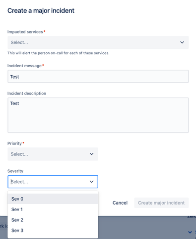

In the "Create a major incident" form that can be opened from a JIRA Service Management ticket, there is a Severity field that can be set to Sev 0/1/2/3.  However, our organization uses a different Severity scheme, and even though I've updated the Severity field's values in JIRA settings (and they are reflected everywhere else in JIRA), it doesn't seem to affect this form.  Is there a way to configure the Severity levels in this drop-down?

The major incident is not a request type. There is integration with Opsgenie in a new Service project. You can create a new service project (ITSM template for example) and then create an issue of [System] Incident issue type and then in the issue, you see the button "Create major incident". When you press it you'll see the screen from the picture in the first post. And if you create a major incident you can process it in Opsgenie.
And actually, the screen looks universal for all projects. I made a test on one cloud instance and deleted the field "severity" at all and what do you think? In the screen of creation a major incident it stays. I think we can't influence the fields on the screen at all.

I have already updated the Severity custom field with different values, and it displays these values in every other screen in JIRA (including JIRA Service Management tickets).  The only screen where it doesn't reflect the same values is in this "Create a Major Incident" form.

Thank you for the suggestion (I didn't think of checking the contexts before), but I confirmed that I have only one Severity field and one context for that field.
I suspect that form just uses it's own built-in value list (or another predefined set of values from OpsGenie that can't be updated, similar to the Priority field).  That's ok for now, it's not a blocker and we can work around it.

I am also trying to customize the options presented on the "Major Incident Form" which is presented by OpsGenie.  This does not appear to be a standard form for any issues, and, in fact, the "Severity" is created and persisted as an "extra property" in OpsGenie.   As such, it seems like after the OpsGenie "Major Incident" has been created (and is linked back to the Jira Service management incident), the property value for the severity in OpsGenie could really be changed to anything I want.
So, the question remains, are the Severity option values presented int the "Create Major Incident" form all hard-coded, or could I configure them to be something else, to better match the severity values we use in the Jira Service Management side of things?
