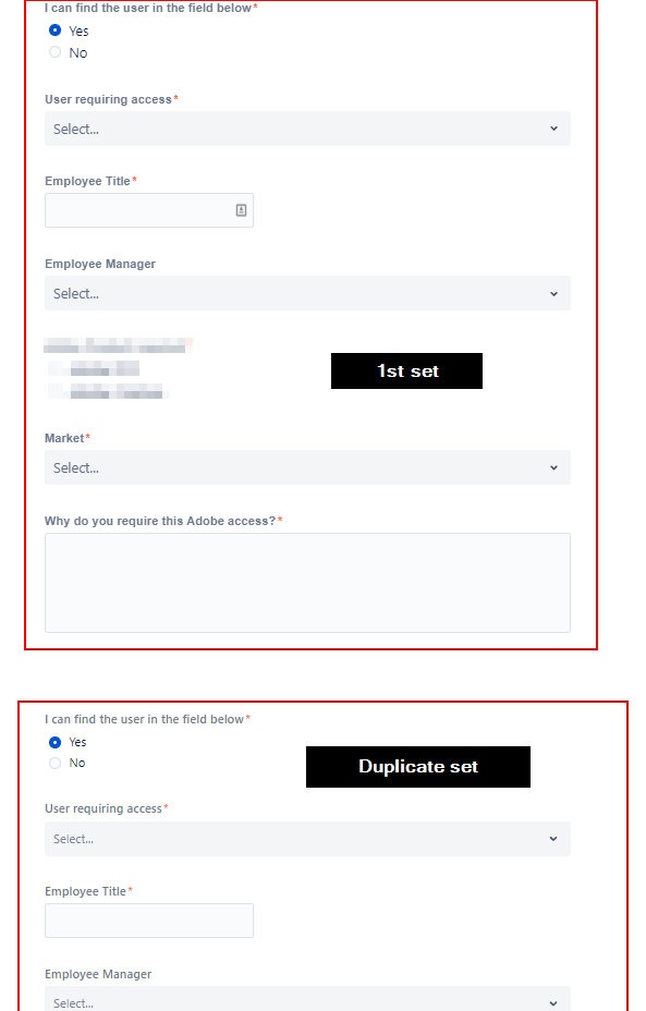

×After the recent improvement of Forms to be integrated with Jira Service Management, the fields in the Portal are all duplicated. Meaning, the set of fields that we already have is being shown twice. 1 set on top, the other set appears under.
Users are also complaining that they are unable to find their names in the custom fields.
Anyone has similar issue?

So we had contacted support yesterday and he mentioned that it was actually due to the update that they've pushed. (Integrate Forms into Jira Service Management)
Since we already were using Pro Forma, they needed to disable that first before integrating the new one.
Refer to the first two screenshots above.
Forms (New) - Added by Jira
Forms- Currently using
Things got back to normal when they rolled back that update.
