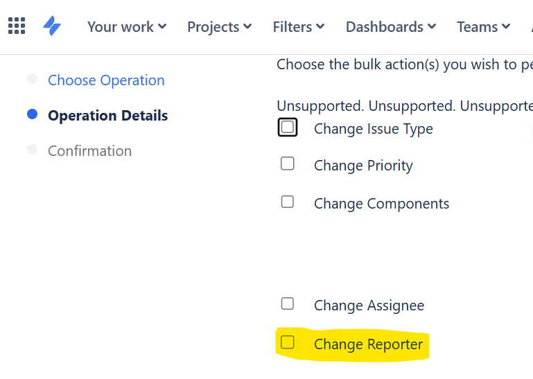

HI - using Jira Service Management Support and I have a few projects that are no longer being utilized.   I want to end date the customers tied to these projects without losing the ticket history.

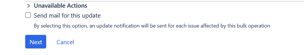

Is this a bulk change - so go to project settings - customers - find the user and click on the Open or Closed Requests and then do a bulk change?    I would want to change the Reporter to someone that should be active.
Make sure to not send the email (so do not check this box)
Can someone please confirm my thoughts here

To address the Bulk Change question, you're pretty much correct on the process. There are some items to consider though:
  1. A bulk change applies to all issues that appear as part of an Issue Search. Make sure that you're extremely specific with the filters you're applying.
  2. Changing the reporter should modify the reporter on all tickets in your search.
  3. If you extend your search to the Assignee field, you'll want to make sure the person you want to put into this field has the "Assignable User" permission. This is a project level permission that restricts which users can be assigned to tickets.
