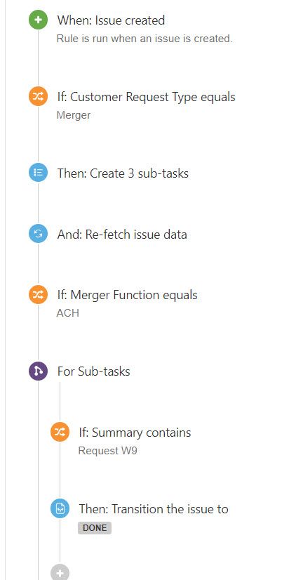

I am trying to puzzle out how to create an automation that will, ultimately, change a subtask status to Done if, when the parent ticket is created, a custom field has a specific value.
I have an automation to create subtasks when an issue is created with a specific customer request type. And this works as it should.
I then tried to write an automation - that when the ticket was created if a custom field drop down value was a specific selection, then a subtask with a specific summary should transition to the Done status.
This version failed to trigger.
I then tried to write it with a different trigger, that when this custom field value was changed, to then mark the subtask's status to Done. But this failed too.
I am testing this in my sample project. I thought I should use Branch Rule/related issues and select Subtasks but this is where my rule keeps failing.
I attached a screenshot of the current rule setup and the fail in the audit log.
What am I doing wrong? I am using JSM Data Center.
Appreciate any advice you can give!

I'm now theorizing that this might be a timing issue? Following the automation rule in my screenshot above, I created a new issue and the status change for the subtask did fail - like it has been. But then I edited the value of the Merger Function custom field - changed it away from what I needed, saved it, then changed it back to ACH and saved it - after this, my rule worked - my W9 subtask status did change to Done.
I'm still building my experience as a Jira admin - if this is related to timing, how would I troubleshoot it?
I think my Data Center equivalent is re-fetch. I can't find a delay action. I tried the re-fetch - I placed it immediately before the Branch Rule and then immediately after it - but both tests failed.
If re-fetch is the next piece in the puzzle, should it be placed before or after the Branch Rule? I haven't used this option before.
Unfortunately it looks like there is no delay equivalent in data center yet.
I did find this article for a workaround but it does say it's a workaround for cloud, so not sure if it can be used

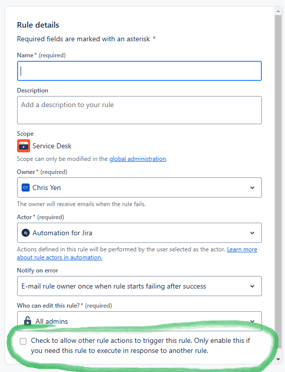

By chance is your rule being triggered by another rule? Something else to check would be this checkbox at the bottom of rule details
Yes, I do have that option checked - because of my other automation to create the subtasks when the issue is created - but my rule still fails.
Can you put this conditional transition at the bottom of the rule that creates the subtasks? You can insert the re-fetch issue data action after sub-tasks are crated then branch rule for sub-tasks
Thank you so so much for all your help! I updated the rule based on your suggestions and it was successful in my sandbox project. Here is a screenshot of the final rule.
