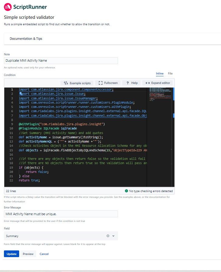

Connie H Johnston June 25, 2024 edited
We ended up using the basic Scriptrunner plugin available with the Validators.  We were using the Summary as the label for the assets object, but wanted to make sure the name was unique.
We had to add a script to include an AQL search to see if there were any objects with the Activity Attribute (label) that matched the Summary entered on the Request Type. Here's what finally worked!
import com.atlassian.jira.component.ComponentAccessor;
import com.atlassian.jira.issue.Issue;
import com.atlassian.jira.issue.IssueManager;
import com.onresolve.scriptrunner.runner.customisers.PluginModule;
import com.onresolve.scriptrunner.runner.customisers.WithPlugin;
import com.riadalabs.jira.plugins.insight.channel.external.api.facade.IQLFacade;
import com.riadalabs.jira.plugins.insight.channel.external.api.facade.ObjectFacade;
@WithPlugin("com.riadalabs.jira.plugins.insight")
@PluginModule IQLFacade iqlFacade
//Get Summary (MMI Activity Name) and add quotes
def activityName = issue.getSummary()toString();
def activityNameAQL = ('"'+ activityName +'"');
//Check Activites Object Type in the MMI Resource Allocation Schema for any objects with an Activty(label)=Summary
def objects = iqlFacade.findObjectsByIQLAndSchema(15,"objectTypeId=229 AND \"Activity\" IN (" + activityNameAQL + ")");
//if there are any objects then return false so the validation will fail
//if there are NO objects then return true so the validation will pass and the new Activity(Suummary) can be added
if (objects) {
return false;
} else
return true;
