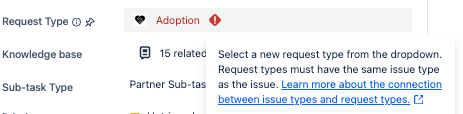

In JSM, when we convert a Request to a sub-task, the Request Type field in the sub-task is populated with that of the initial Request with red text and an error message around it.
How do we clear this out as obviously a sub-task doesn't have a request type and the red text looks bad.

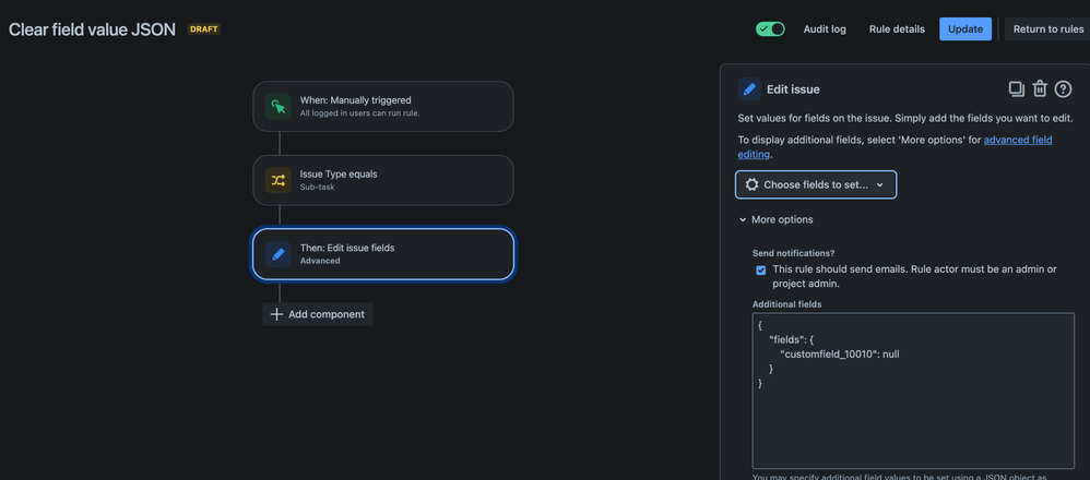

On converting an issue to a sub-task the trigger in an automation can't be the Field Changed based on issue type as the convert action doesn't trigger an automation rule.
See, JSWCLOUD-22432
So your automation should trigger on something else defined in the converted issue, or use a manual trigger.
The edit should be an advanced JSON
Example rule, with edit to clear Request Type:

James Murray November 12, 2024
Thanks Marc, I will give this a try!

James Murray November 12, 2024 edited
This works perfectly. Thanks so much @Marc - Devoteam
My automation runs on an hourly schedule for any sub-tasks where:
"Request Type" IS NOT EMPTY
This is fine as doesn't need to be real time and will just fix any it sees within an hour.

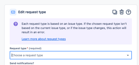

If I then use the Edit request type action then it won't allow me to leave it as blank:
Could you show me your automation and how you were able to achieve this. Maybe I am missing something.
