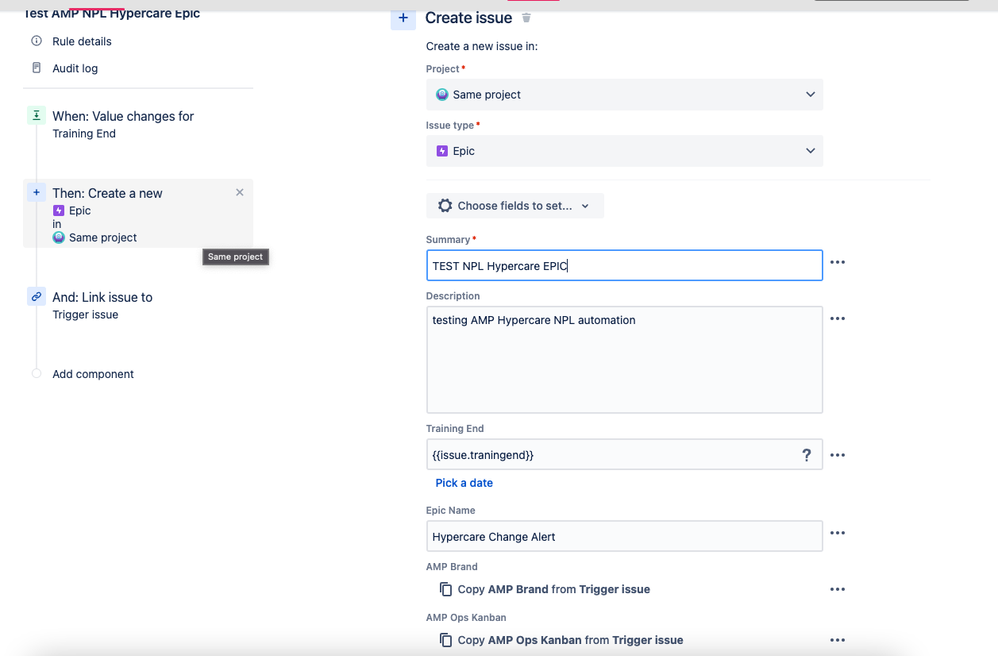

Hello Mark,
Thank you.  The purpose of the Automation is to get the Details section to auto populate a few fields, one being Epic Link.
So far I was able to get a few fields to auto populate, however not the Epic Link.  Need it to populate on the triggered issue related to Epic when created.
See details of my current Automation rule.    The question is do I need to add Epic Link to the second part of Automation rule?  I had this added originally however the Epic Link did not populate.
Trigger: Field Value Changed (Training End)
Action:  Create a Epic
Action:  Link Epic
Thank you

Link issue is not for epics.  That is only for creating links between issues (e.g. Blocks, Clones, etc.).  You'll instead want the Edit Issue Action with the {{createdIssue}} smart value for the the Epic Link value.
