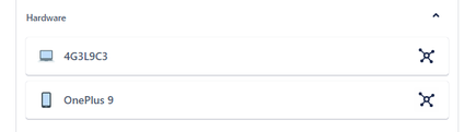

Trying to implement Jira automation (when issue created) that would lookup from Jira Assets all hardware assets (schema: Hardware Assets, and its childs like "Laptops", "Phones") and where {{reporter}} is marked in objects attribute field "User".
From the lookup output -> I wish to read the "Name" attributes and store them to my Jira custom Asset Object field named "Hardware". As end results, Hardware information in ticket should be similar to if I added them manually (picture below).

Hi Ariraati,
Its definitely possible.
In the Custom field Reporter Assets you set up something like:
In the IT Employee Assets schema you should have an Owner that references back to the Schema that has your EMployees, like:
Over in the People schema, you have the User, which is where the Atlassian ID is stored.
So the field will reference Owner.User where the field = the Atlassian ID.
