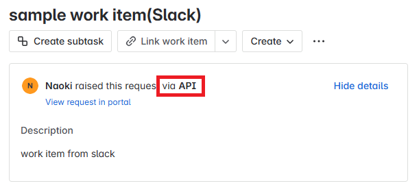

I created automation to add comment when work item created.
I would like it to run automation only when created from Slack, but it does not.
Does anyone know how to do this?
I believe we can handle this in IF condition if we can get "via XXXX".

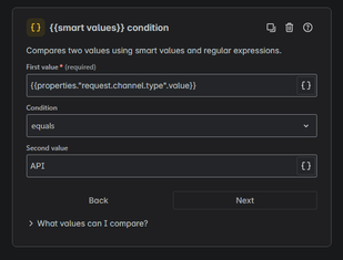

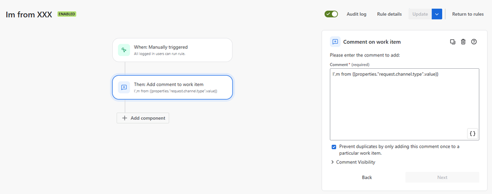

Hi @Naoki ,
Use a smart value condition on {{properties."request.channel.type".value}}

Naoki
May 21, 2025
Hi @Bob Dalm , thanks for reply.
AWESOME ANSWER!
I used the smart value, it works fine!
Thank you for your help.

Jack Brickey
May 21, 2025
Hi @Naoki , I haven't investigated this in a while but I seem to recall that there was some text in the Description that indicated a work item being created from slack. In your image I note "work item from slack but that may simply be something you entered during test? If there is some text that Slack creates then you could use in a condition.
