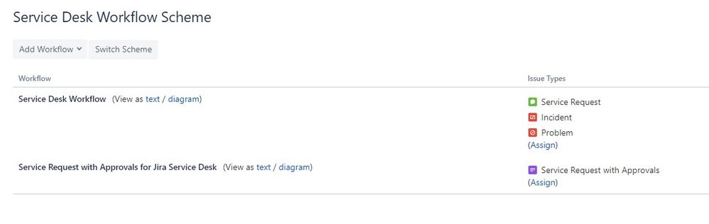

WorkFlows.jpg It appears that they use the same workflow. Regardless, It makes ZERO since that I can make the change manually but not through automation.

I totally get what you are saying but its kinda a fail safe system. You can manually make the change because you know what you are doing in that exact moment and whatever you lose you lose, or you can save that info.
If its automated, you may accidentally lose thousands of pieces of information and not even know it. While I would opt for it to be there, I do understand why its not.
