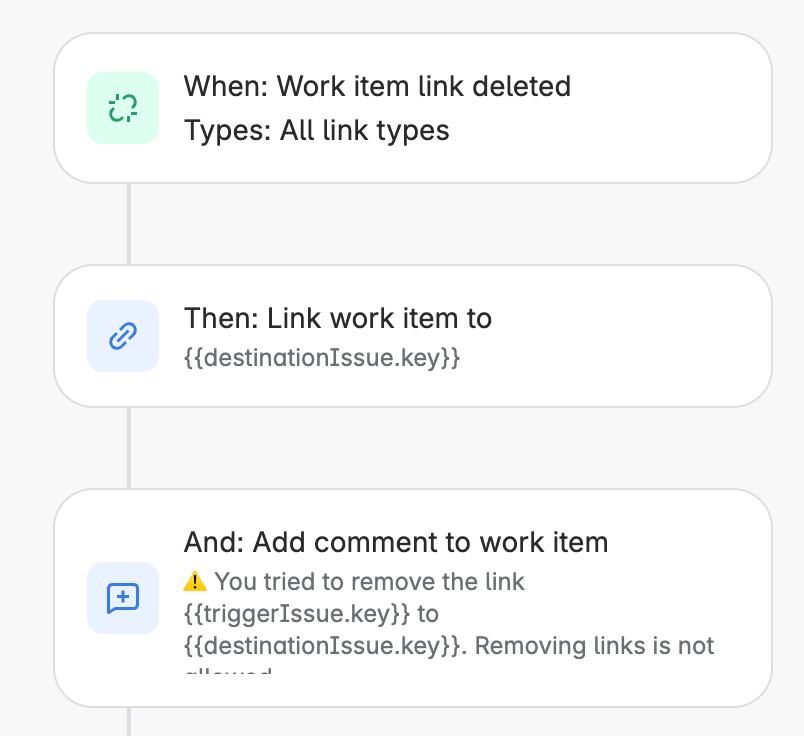

Hey, @Alessandro Micheli! Unfortunately restricting removing links is not possible. However, you can build an automation rule that restores the link and notifies the user by adding a comment that they tried to remove the link.
You can build the automation that is triggered when work item link is deleted:
Additionally, you can add more validations to the rule, if necessary.
Hope this helps! ✨

Hi! Try to prohibit users from changing links, but at the same time make a manual rule for Jira Automation, which will make such a link upon entering the key. You can add types of links there in the selector and the main thing is that the rule works on behalf of Jira Automation.
