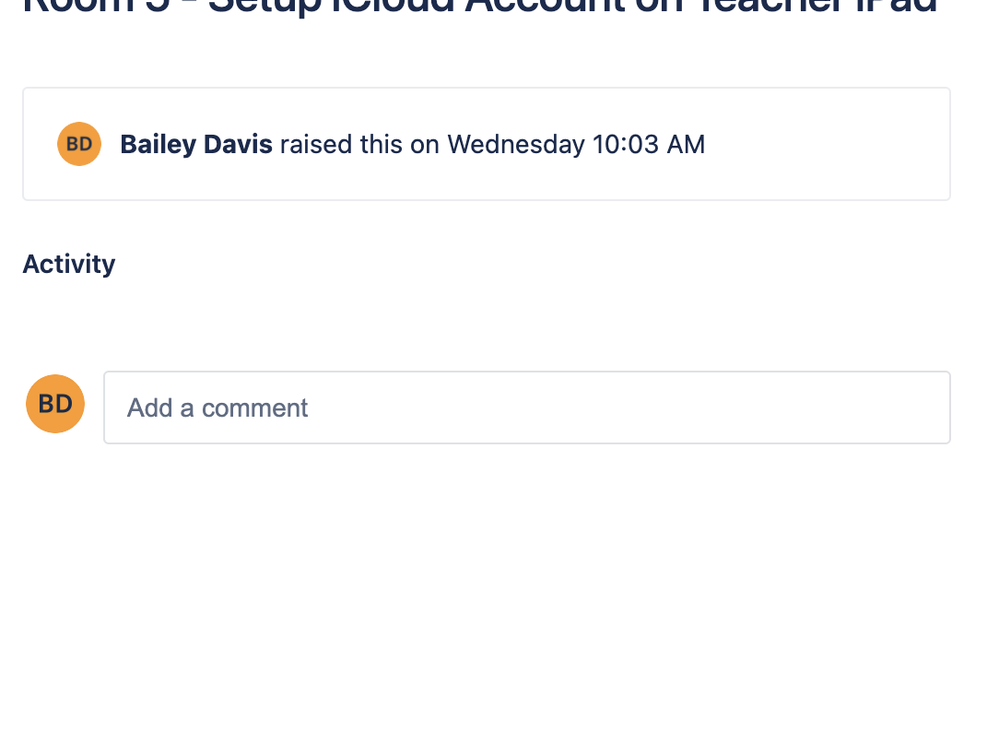

For some reason my customers are unable to see the description of their issues in the customer portal, I have checked to ensure the field is set as visible, which it is, but they still are unable to see it.

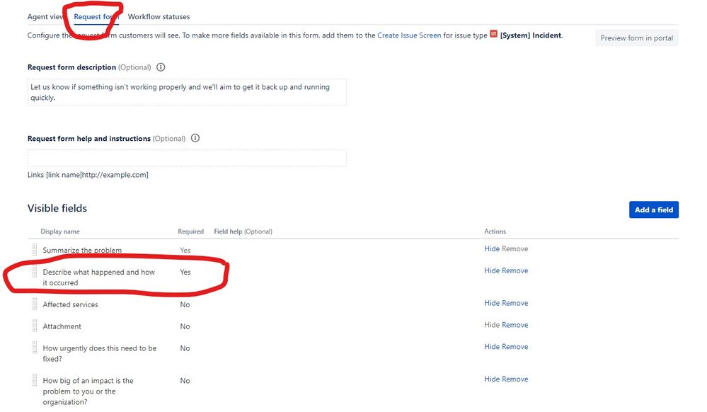

I checked similar cases and all of them are the request type or the description field not added to the request type.
What Joseph mentioned is also important to check. On the request form, it’s possible to add a display name for the fields, so it will show different names in the portal and in the agent view.
Can you please click on “Body” to confirm if it’s the Description field?

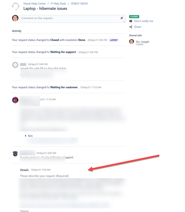

Joseph Chung Yin
May 31, 2021
@Bailey Davis -
If the portal, customer should see the "Description" field (the field they entered) at the bottom of his/her issues under the Activity section (See example below).  When an issue is created, the content should be listed under the "Details" area.
You should also check to ensure that your "Body" field is mapped correctly to the "Description" field in your Request form.
Please let me know if it is properly mapped.
Best, Joseph Chung Yin

Bailey Davis
May 31, 2021
Yeah, there is no description anywhere on the customer portal in the Issues
Joseph Chung Yin
May 31, 2021
@Bailey Davis -
Take a look at what Atlassian Team reply in this ask.  Also did you confirm that your BODY field for the request form is mapped to the actual Description field in your JSM project?
@Katarzyna -  I know that my image screenshot is from the server version.  In most cases, the server display is similar/common to the cloud display.  Thanks for pointing that out.
Best, Joseph

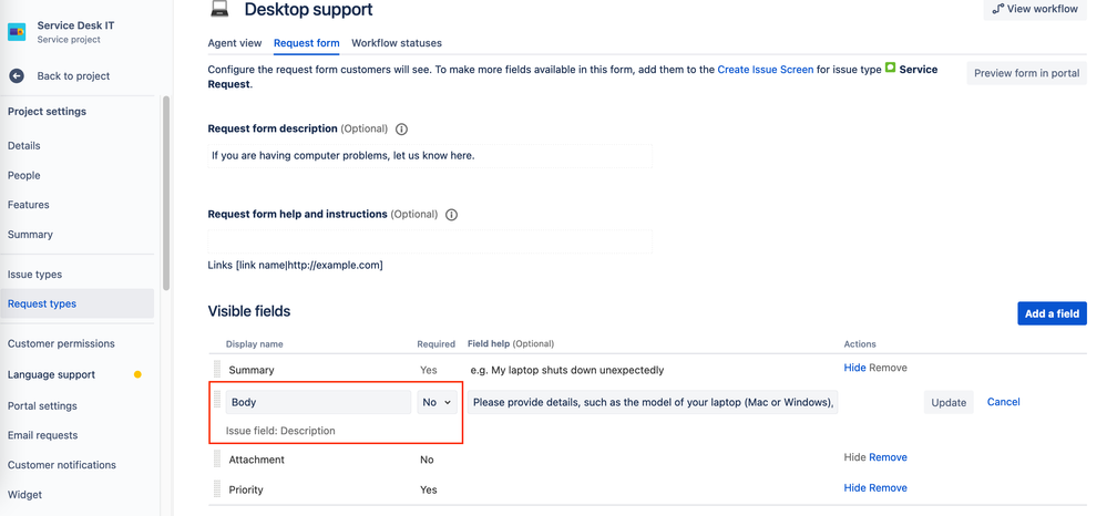

Ajay _view26_
May 30, 2021 edited
Hi @Bailey Davis
The issue seems to be the Body field is not set as required.
In-fact the field needs needs to be set as required in the"Request form" for it to be visible in the Portal Page. See attached screenshot
Bailey Davis
May 30, 2021
Not sure what your screenshot is, but I changed it to required and submitted a new ticket, still cannot see the description in the customer portal.
Ajay _view26_
May 30, 2021
@Bailey Davis
Oops that was a wrong screenshot and I have corrected it
Bailey Davis
May 30, 2021
Yeah I changed that and it didnt affect my issue.
