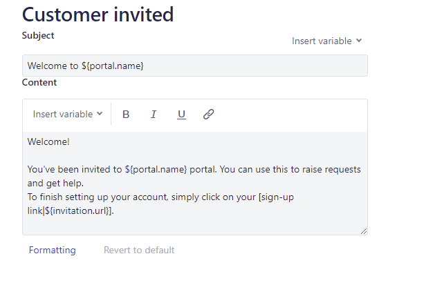

Thanks @Adam Rypel _MoroSystems_ , I don't see that option within the edit invitation email section, I just see the below?
Hello @Boxphish Technical Team ,
sorry for the delay.
Please ignore my question about editing the invitation.
