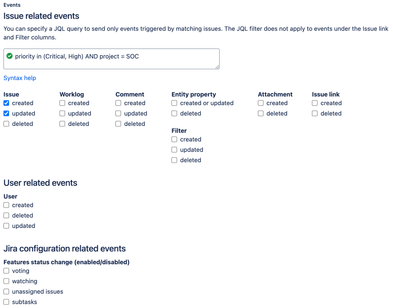

Here are the webhook settings:

Hello @Callum Brown
Update your webhook events from issue_created / issue_updated to Jira:issue_created / Jira:issue_updated if you are using an equals condition; otherwise, use contains.
Callum Brown May 20, 2024
Thanks for sending this over.
I just tried this but it made no difference.
It's worth noting that alerts are being created without any issues and this is using "webhook event equals issue_created".
