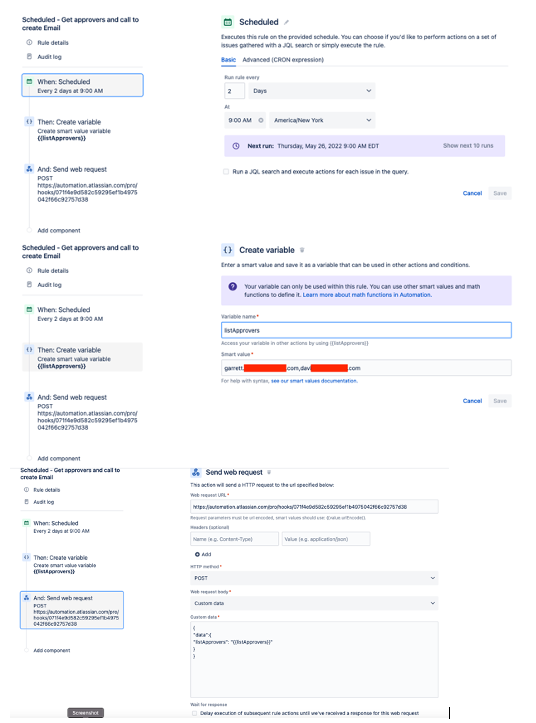

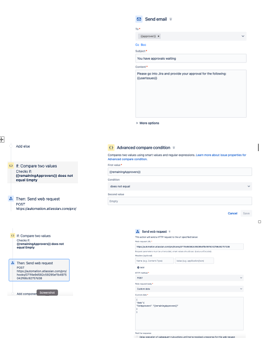

ok, this works... It's a little bit of work, but I hope the documentation makes sense...
This will require 2 automation rules, with the first one calling the second, and the second one calling itself (until there are no more approvers).
Automation 1:
Step1: Scheduled (no JQL) trigger
Step 2: Create a variable with list of approver emails separated by commas
Step 3: Send a web request passing the listApprovers. The URL used here is generated when we create an incoming webhook automation (the 2nd Automation). The custom data should remain as shown.
Automation 2:
Step 1: Incoming Webhook trigger
You will notice that the URL here is what is being used in the prior automation step. Be sure to select No issues from the webhook.
Step 2: Create variable getting the 1st approver
Step 3: Create variable taking out the 1st approver from the list (has remaining approvers)
Step 4: Lookup Issues using the approver in the JQL
Step 5: Create a variable with key and summary of lookupissues
Step 6: Create Variable (Update that variable to remove the last comma)
Step 7 and 8: Make sure there are issues before sending the email (IF ELSE and Send Email, nothing goes in the else part
Step 9: See if there are any remaining approvers
Step 10: Send Web Request (Calling the same automation, passing the remaining approvers minus the one that we removed). This will continue to call until there are no more approvers.

Mihir Ruparelia
May 25, 2022
@Garrett McCreery Just seen this, I will read through it now and give it a go. Thank you I'll come back with feedback once tested.
Mihir Ruparelia
May 25, 2022
@Garrett McCreery sorry some of the screenshots are a bit blurry so when I am trying to add the webhook and variable I can't see what I need to add as a smart value.
Also do I need to complete Automation 2 to generate the URL and then put this into automation 1?
Sorry again this is all brand new to me, so just learning as I go along. But this is helpful to know.
