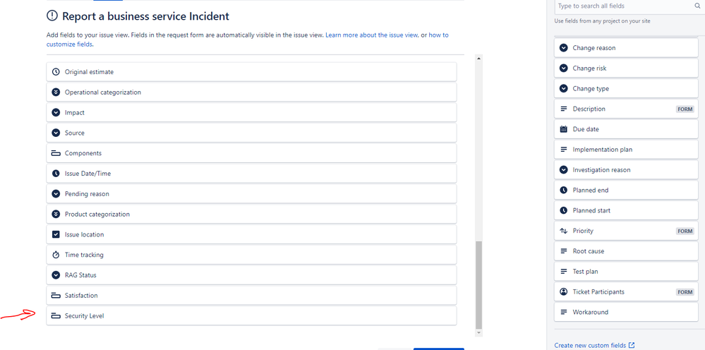

I've got so far with this but I'm now struggling with getting the Security Level field to appear on the Agent views so that it can be set by the Agent.
I think I've followed the instructions best I can, but the field isn't there.  I've also tried to go into the Request Form, the View issue tab, and drag the Security Level field into the View but when I SAVE it disappears.
There must be a step I've missed but I can't figure it out.
paul_creedy
April 4, 2023
Example
I copy the Security Level field from the available fields on the right to the view and hit save.
The view refreshes and the Security Level field has removed itself after Saving.
Mikael Sandberg
April 4, 2023
Okay, have a look at the screens associated with the issue type used by the request type to make sure that the security level field is on those (just go to Project settings > Screens and locate the screen used by the issue type). Next thing you need to check is that the service desk team role have the permission to set issue security in your permission scheme (Project settings > Permissions).
Mikael Sandberg
April 4, 2023
Btw, what you see when you add the security level to the request type is expected, the security level has to be added to the screens used by the issue type. This is because you cannot have for example two request types associated to the same issue type and only apply the security level to one of those two request types.
paul_creedy
April 4, 2023
Thanks for replying
I've been through this several times and now whilst getting screenshots I noticed something........
I was expecting the security box or the field to be on the right as I've seen in other screenshots, but instead I've just noticed padlock icon over the right had side.  Clicking that icon shows the missing panel - YHAY!
Was that padlock always there? I don't know, but the issue ultimately was that I was expecting there to be a new field, or a new panel not a tiny icon that you had to click.
No where in the documentation that I read do I remember it saying you had to click that padlock icon to access the panel.  The Jira documentation could do with some screenshots not just line by line instructions.
Thank you for your time and help

Mikael Sandberg
April 4, 2023
That is the new issue view, it moved the security level from showing as a field on the right to now using the pad lock icon. Here is a KB that shows the new location.
