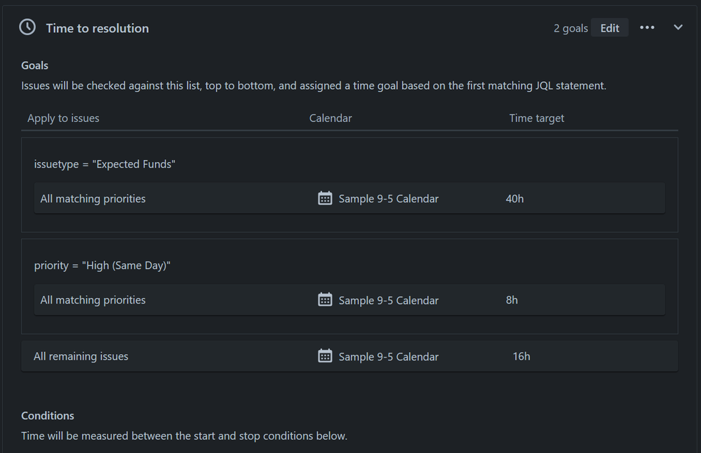

Are the triggers you're referring to under the 'conditions' section of the SLA configuration? Here are the screenshots from each project.
Project A:
Project B

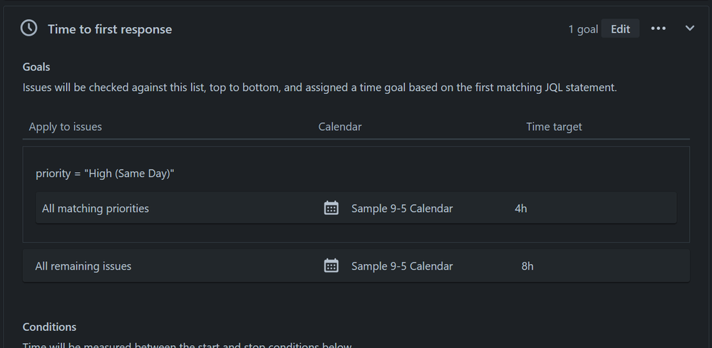

I've also just realised that Project B has a Time to First Response SLA too, and Project A does not - can that interfere with this somehow? Screenshots below.
