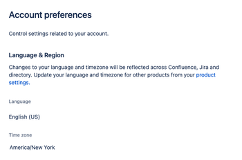

Here is an example of me changing my TimeZone and it not being reflected in the description correctly. I am the reporter of this issue
CURRENT PROFILE TIMEZONE
DESCRIPTION AFTER UPDATE OF START DATE - ACCURATE

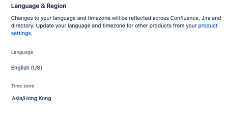

UPDATED TIMEZONE TO ASIA/HONG KONG
DESCRIPTION AFTER UPDATE OF START DATE - INACCURATE EXPECTED GMT+8, CST

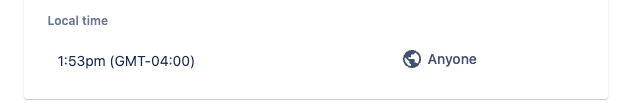

Hi @Miqueas Milanesio _Appricity_ , the issue at the time of building this rule actually was not smart value related, but its due to the user's profile visibility for the local time.
If the visibility isn't set to "Anyone" the system can't retrieve their local time. I believe this is due to security reasons on the Atlassian side to have this visibility setting not be "Anyone" by default.
We instructed our users to access their profile and make it visible to anyone if they would like but not required. For the ones that did this update, it is working.
