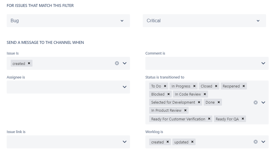

I ran into this same problem, and I ended up using the new Automation functions to solve it. (assuming you're on Cloud, it should be included)
  1. Project Settings --> Automation
  2. Create rule
  3. When: Value changes for Priority
  4. If: Priority is one of Critical
  5. Then: [do the thing that triggers notification]*
  6. Save. (note, you can also make it apply Globally)
  7. Back to your Project, click on Slack integration
  8. For your Notification, click Edit
  9. Make sure [do the thing that triggers notification] is listed here
  10. Save changes
  11. Test and confirm
*For the thing that triggers notification, I used "Log Work", because that's something we never use otherwise. You can also do things like "Add comment to issue", etc.
Hope this helps.
