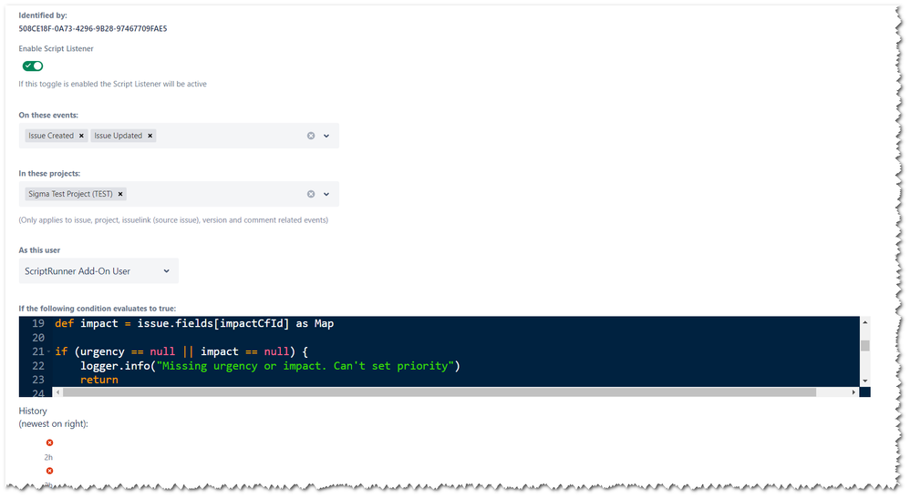

Zaldy Parian
November 12, 2023
Hi @PD Sheehan ,
I updated and pasted the code under the "If the following condition evaluates to true"
Cheers,
Zaldy Parian
November 12, 2023
Hi again @PD Sheehan ,
I moved the script to "Code to run" space. And updated the Urgenct and Impact of an issue in my TEST project.
Although the priority remains unchanged, when I look at the script, I noticed there were green ticks (as opposed to red Xs earlier).  I guess we are going to the right direction. I just need to figure out why the priority did not change.

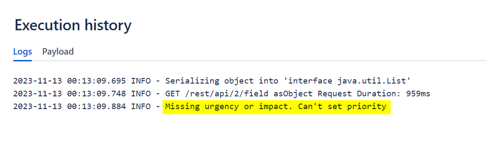

Zaldy Parian
November 12, 2023
And I checked the log. It says missing urgency or impact
Like Joseph Chung Yin likes this
PD Sheehan
November 12, 2023
Did you make sure the fields name match with the correct case?
it my original example I had impact with lowercase i.
Zaldy Parian
November 12, 2023
Hi @PD Sheehan ,
I think I found the issue with the script. I have typed in the field name inaccurately. When I changed the field name to have capital letter at the start, then the auto setting of priority worked!
Thanks again for your patience and guidance. Same goes to @Joseph Chung Yin for his references.
