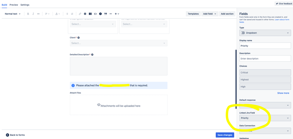

You can link form fields to Jira fields in the back end. This creates a dependency. I appreciate that the logic to determine if this "is being used by a project" may be complicated, but effectively the field is now being used and should increment the counter.
If, for example, you use a field in a JSM portal request type without a form, it DOES reflect in the custom fields list. This shouldn't be any different.

Yes, but the issue fields you link to are issue fields.  You can see those listed in the custom field list and check their context, but you'll also need to look at the screens and field configurations to see if they are actually presented to the users in the project.
The fields in a form are not issue fields and do not exist outside the form you have put them on.

What I'm trying to say is IF you link a form field to an issue field, it should then indicate in the custom fields list that the field is now used in the given project. This would be the same as the existing behaviour where adding an issue field to a screen will result in the project showing on the custom fields list (because the field is in use).
Since it does not do this, it runs the risk of removing custom fields that look unused, but are actually linked to a form.
