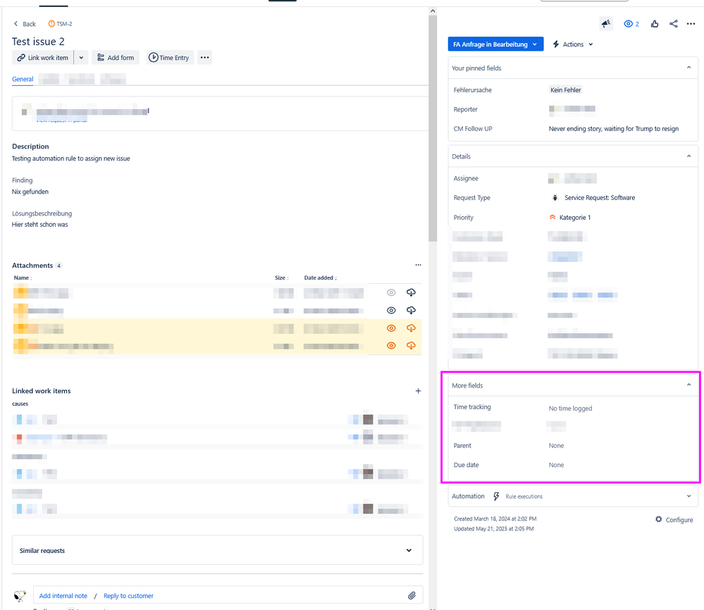

In a Jira service management (cloud based) a work item can have fields which do not contain values. Thus these fields are on the block "More fields" which is fine.
The issue is, that not all users of the project see this block.
The question is: What is the deciding factor to specify/switch this block on/off?

Are the users who don't see that block the ones without Edit permissions?
If that's the case, then it's expected behavior — users who can't edit issues won't see that section.

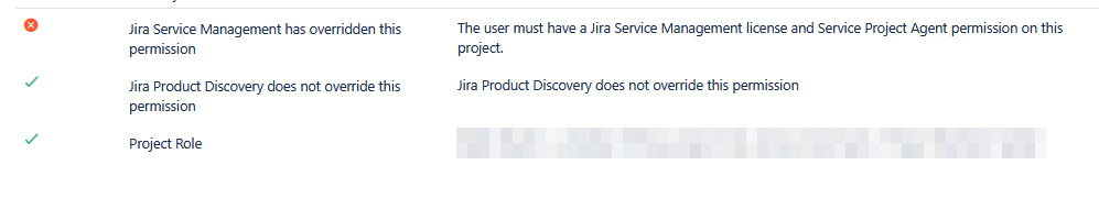

Thanks @Evgenii for the hint. The person itself is in a group which explicitly has the rights to edit the issue.
But using the permission helper it shows, that somebody is overwriting this.
The questions are: Why? And how to change that? Giving everybody a Service Management license is NOT a solution.
It's Atlassian policy. Only Service Desk Agents can work with issues.
https://support.atlassian.com/jira-service-management-cloud/docs/what-users-and-roles-are-there-in-jira-service-management/
