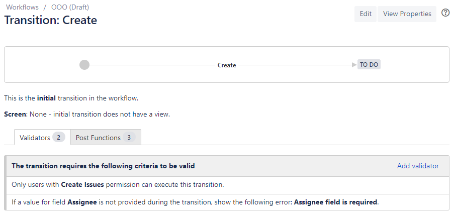

Regarding workflow configuration, it will be as simple as possible:
  • single status "To Do"
  • built-in "Create" transition with configured validator ensuring that user will fill in the Assignee field during the issue creation
  • "Configure OOO" loop transition is used to configure autoresponder attributes. We will add a screen to this transition with the following fields: Info message, Start date, End date, Coverer, Auto assign. We should also add two validators: one to ensure that the user will fill in the Start date and End date fields and another that checks if the End date is later than the Start date.

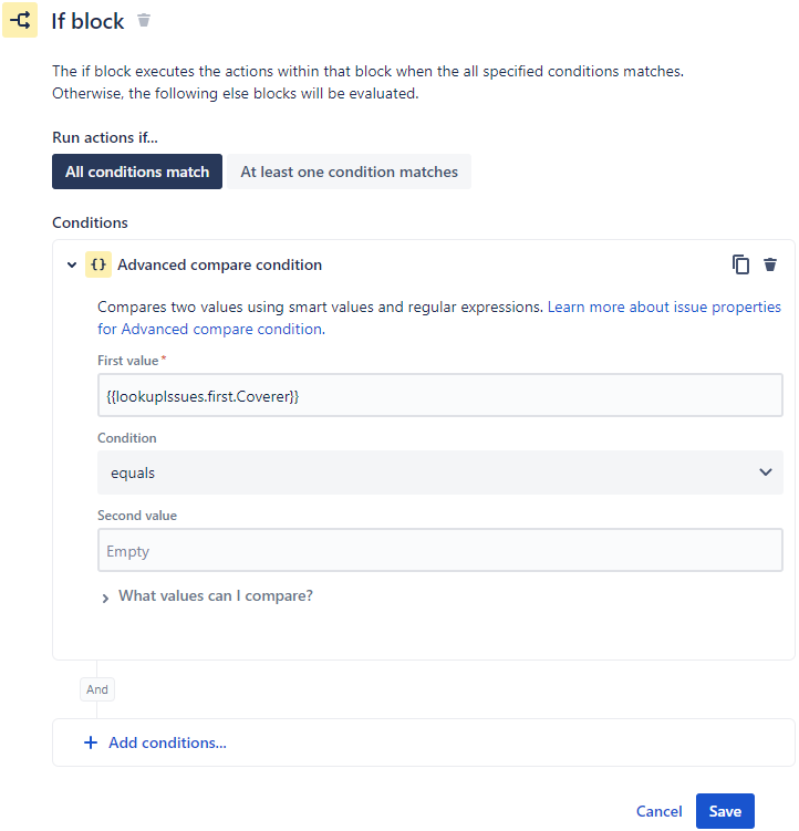

  4. Main rule components are divided into 3 sections differentiated using if / else conditions:
    1. Used in a case when the user did not configure his Coverer (left this field empty)
      • "If" block with Advanced compare condition: {{lookupIssues.first.Coverer}} equals Empty

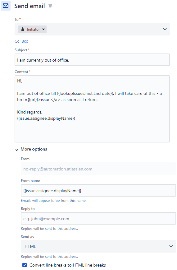

      • Send email action: To Initiator with filled-in Subject and e-mail content (you can use smart values ​​here to make it look more pleasant to end users) and set {{issue.assignee.displayName}} in From name field.

      • Send email action: To Initiator with filled-in Subject and e-mail content (different than previous because inside the message we are informing who is the Coverer) and set {{issue.assignee.displayName}} in From name field.

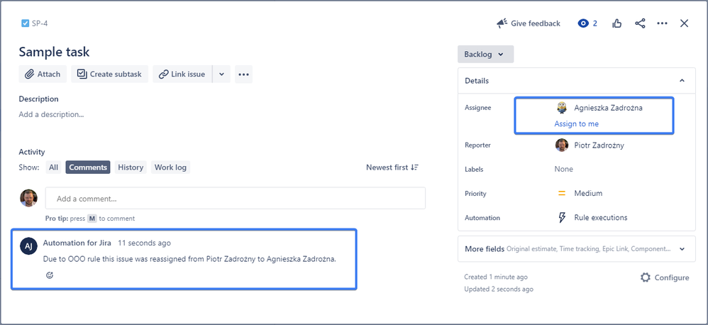

    3. Used in a case when the user configured Coverer and set Auto assign to On to automatically reassign all issues to configured Coverer apart from sending autoresponder e-mail:
      • "Else" block with Advanced compare conditions: {{lookupIssues.first.Coverer}} does not equal Empty and {{lookupIssues.first.Auto assign}} equals On
      • Assign issue action configured to assign the issue to Smart value and setting the user as {{lookupIssues.first.Coverer}}
      • Comment on issue action to ensure that in the issue comment section we will find information that it was reassigned

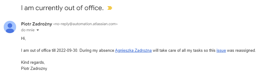

      • Send email action: To Initiator with filled-in Subject and e-mail content (indicating who is a Coverer and that issue was reassigned to one) and set {{issue.assignee.displayName}} in From name field.
Working solution
The solution should now be fully functional. The user can configure his autoresponder rule. In his absence, when he is assigned to any issue, the configured rule will be applied. In the presented example, an e-mail will be sent to the user who assigned the issue and the request will be reassigned to the configured Coverer with an appropriate comment added.
