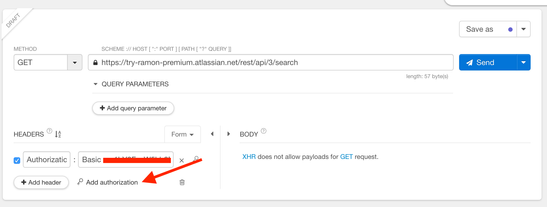

Apitokens shouldn't be affected by your team's implementation of SAML. With or without SAML, apitokens are used to authorized API calls into Jira cloud via Basic Authentication.
To use that, you will need to add an authorization to your rest call.
The username will be your email address and the password is the apitoken string. Talented will convert that for you into the proper Authorization header which will be sent out with the rest call.
I hope this helps.
