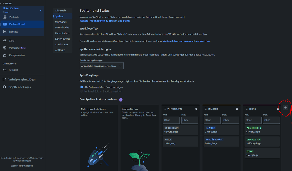

Hi y'all,
i'd like to have another column in my kanban-board.
If i want to add a new column it says: Please add status in your kanban-board before, so that the column could be displayed on your board.
Thanks in advance.

Hello @Julian Vollmer
Based on the image you provided you are working with a board for a Company Managed project, and the project is not using the Simplified Workflow.
Do you want to only add a new column, and move one of the existing statuses to it? Or do you want to add a new column with a new status?
If you want to add a new status, only a Jira Administrator can add a new status to your workflow.
Julian Vollmer June 6, 2024
Thanks for the quick reply.
I want to only add a new column, and move one of the existing statuses to it.

You said you just want to add a column to the board and rearrange the existing status/column mapping without adding a new status. That should be possible for a user that is a Board Admin and/or a Project Admin, according to this article.
https://support.atlassian.com/jira-software-cloud/docs/configure-columns/
If you would like to continue debugging this with us, can you
1. Confirm for us the type of project with which you are working? You can get that information from the Type column on the View All Projects page under the Projects menu.
2. Show us what happens when you click that + button to the right of the columns? Are you able to click on it and get some reaction?
