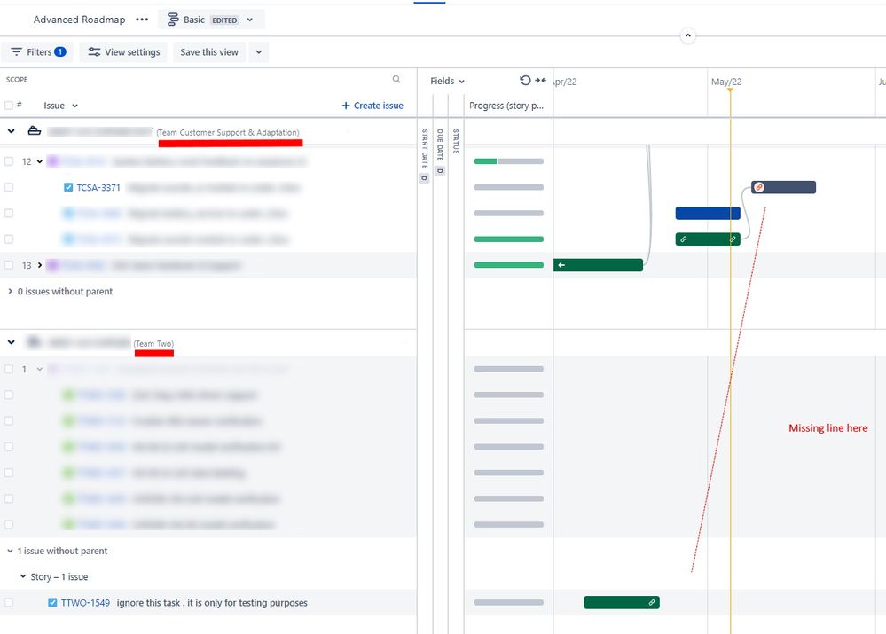

If I have the "line" option selected to show the dependencies, when I add depencency between two tasks within a team , we can see the lines from one to another. Also all good here.
However, when I try to add a depencency between two different teams/projects, the lines do not show. The dependency is created, because if I go to the source task, I can see that it is blocking the other one, but no line is visible, which somehow blows one of the nice features of the advanced roadmaps, which is outlining the external dependencies in a very visual way.

by trying for several hours i found out that depending on the Filter settings, the lines are showed or not. Specifically the "Group by" field sees to make a bog difference. But still, when you group issues by Project/team, the lines are not shown, which clearly hinders one of the nicest features of AR, which is easily tracking dependencies between teams
I have the same issue too. The dependency lines between tickets from different projects show up when `Group by` is set to `None`. As soon as I set `Group by` to `Project` or `Team`, which is a more useful view, they are gone.

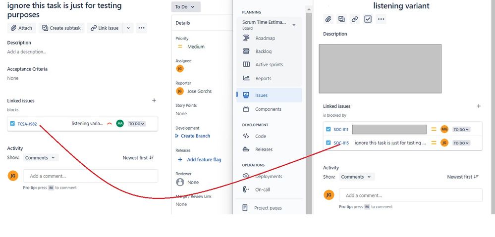

I was checking to be sure and the answer is yes.
on the dependencies where I can see the lines: on the blocking task I can see that in the "linked tasks" section there is a "Blocks" link to the right target. and on the target task I can see the "Is blocked by" task listed there.
I can also see the same links in those cases where the lines are not visible.

sure
the settings seem to be correct (actually some of the lines do show up)
so, in the screencap below, tasks 1549 and 3371 do have a depencency link, but the line is now showing and as you can see some of the other depencencies (the ones within the team) do show up
