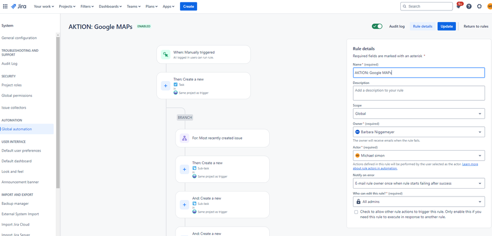

Can you share the actual rule? Showing the rule details page.
Michael simon September 8, 2024
Since every automation on every project is not working, I am not sure if you will see something. But I will make screenshots for you for the trigger, since the trigger doesn't seem to work. Otherwise I probably would of seen some kind of usage log file.
Here are the images of two different triggersScreenshot 2024-09-08 201129.png Screenshot 2024-09-08 201045.png Screenshot 2024-09-08 201028.png Screenshot 2024-09-08 201011.png Screenshot 2024-09-08 200936.png :

Thanks for sharing those. Does the error happen when you try to do the manual execution? Or just when you open the rule?
