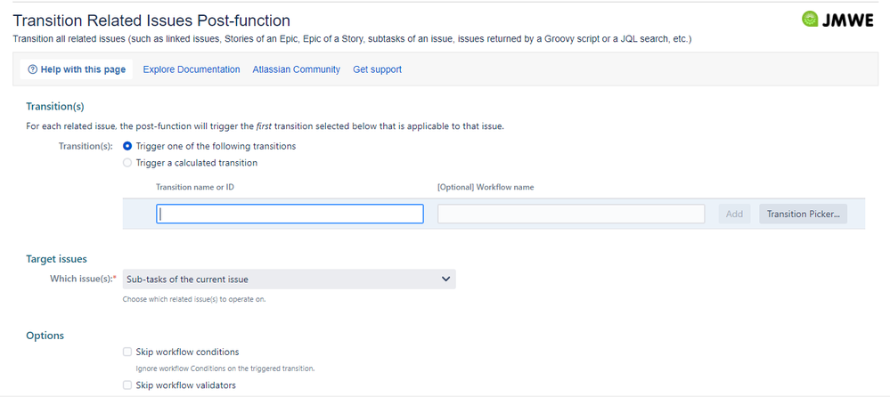

if you have JMWE, you can simply use a "Transition Related Issues" post-function, no scripting required.

In the Attached attachment could u please explain how the fields to be filled for  "Transition Related Issues" post-function,Transition PostFunction Steps1.PNG

Hi @Ravi Kanth ,
  • Under Transition(s), add the transition name or ID of the transition to trigger on Project2 issues (e.g. "Close Issue"). You can use the transition picker or just type the value
  • Target Issue(s): select "Issues linked to the current issue through the following link type:" and then, under Issue Link, select the link type direction that links Project 1 issues to Project2 issues
  • If the "Close Issue" transition of project2 has a transition screen, you might want to add the fields of that transition screen under the "Transition screen" configuration section to provide a value for those fields

  • Transition(s): add the transition name or ID of the transition that takes GCOOPS issues from the "Raised Outside Project" status to the "Done" status
  • Target issues: select "Issues linked to the current issue through the following link type:" and then select "has to be finished together" as the Link type

The easiest is to add the missing transition and hide it from users by adding a "Hide from users (JMWE app)" condition on that transition. This way you'll be able to transition directly from Raised outside project to Done using the Transition Related Issues post-function, but users won't be able to.

The steps u provided its worked thanks from bottom of my heart..

I am not seeing the option of Target Issues in this post-function. Could you please clarify on this. BTW I am using cloud version of JMWE plugin.

it's the first option at the top (in the "Issues to operate on" section).
