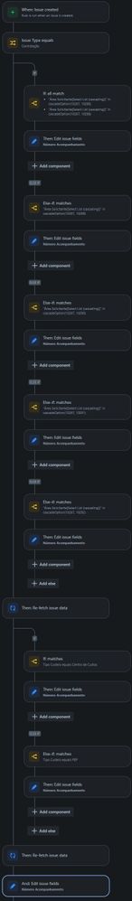

For anyone who has a case similar to mine, below I will leave a screenshot of how my automation turned out.

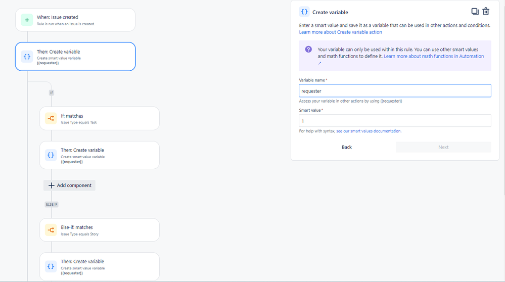

Evgenii
January 3, 2024
Got it. Use variables. Look at my examples, they can give an idea, how it can be implemented.  You need to make variable, then assign value to it, depending on selection, made in Requester field.

Evgenii
January 3, 2024
Hi @Maycon de Souza Leal
You're working with a field that contains text values, each correlating to a specific numeric value. However, Jira doesn't automatically recognize this relationship. Our goal is to instruct Jira on how to associate each text value in the field with its corresponding numeric value, as demonstrated in my example.
Here's what I did in my example:
Creation of a Variable: I introduced a variable named {{requester}}.
Setting Up Conditions: I then constructed a series of conditions. Within these conditions, the {{requester}} variable is assigned different numeric values based on the selected text value from the field. In your case, substitute "Issue Type" in my example with your "Requester" field. Depending on the option chosen, set the {{requester}} variable to 35611, 35621, or 35631.
Utilizing the Variable: Now that you have the {{requester}} variable containing the desired numeric value, you can insert it into a text field. Combine it with other smart values you wish to use, like this format:
GIT-{{requester}}-{{issue.customfield_11111}}-{{issue.key}}.
This method effectively maps the text selections to their respective numeric values, allowing Jira to process them as needed.

Unfortunately I was unable to create using the "Create Variable" component that you mentioned. But I managed to create it another way.
I only used the "If" and "Else if" components.
Oh, and thanks for the tip with custom field cascade, it was very useful.
