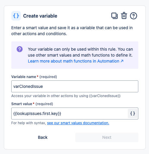

  6. Create a variable to store the issue key of the source issue (A-1). Here is the detail of the action.
