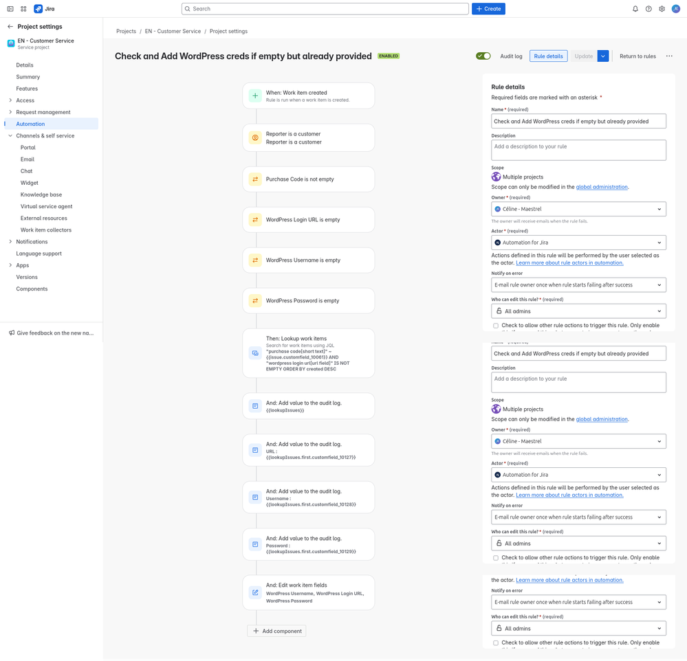

Hi @Bill Sheboy, thank you for your help. "Lookup work items" was what I had to use. Much more straightforward and easy to use.
I copy below my rule, for whoever comes across a similar need/question.
Like Bill Sheboy likes this

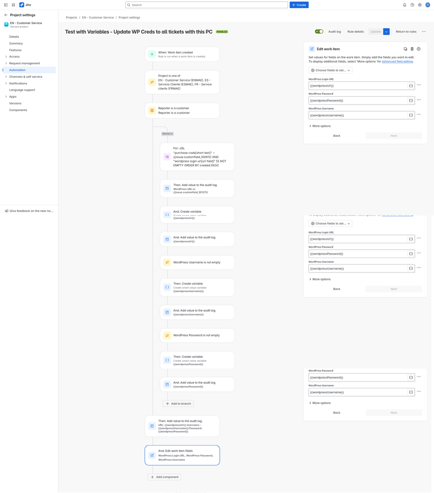

I have as well tested to use Variables (as it seems more appropriate than Issue property), but I still can not make it work...
Rule - Using Issue property
Rule - Using Variables
Results of both rules
For both rules, I have the correct values logged in the branch. I know that I have retrieved what I need. However, I can not figure out how to use these values to update the work item that triggered the rule  (the one not in the branch), to be updated with these values.
