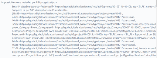

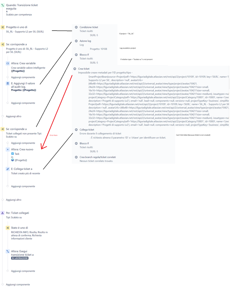

Here the screenshot of the automation and the transcription of the log:
------------------------------ LOG -------------------
Dettagli azione:
Condizione ticket
Ticket risolti:
SILRL-5
Azione log
Log
Progetto: 10108
Blocco If
Ticket risolti:
SILRL-5
Crea ticket
Impossibile creare metadati per l'ID progetto/tipo -
SmartProjectBean{source=Project{self='https://liguriadigitale.atlassian.net/rest/api/2/project/10109', id=10109, key='SILRL', name='SIL_RL - Supporto L2 per SIL', description='null', avatarUrls={48x48=https://liguriadigitale.atlassian.net/rest/api/2/universal_avatar/view/type/project/avatar/10421, 24x24=https://liguriadigitale.atlassian.net/rest/api/2/universal_avatar/view/type/project/avatar/10421?size=small, 16x16=https://liguriadigitale.atlassian.net/rest/api/2/universal_avatar/view/type/project/avatar/10421?size=xsmall, 32x32=https://liguriadigitale.atlassian.net/rest/api/2/universal_avatar/view/type/project/avatar/10421?size=medium}, issuetypes=null, projectCategory=ProjectCategory{self='https://liguriadigitale.atlassian.net/rest/api/2/projectCategory/10001', id=10001, name='Livello 2', description='Progetti di supporto Lv2'}, email='null', lead=null, components=null, versions=null, projectTypeKey='business', simplified='false'}} Project{self='https://liguriadigitale.atlassian.net/rest/api/2/project/10109', id=10109, key='SILRL', name='SIL_RL - Supporto L2 per SIL', description='null', avatarUrls={48x48=https://liguriadigitale.atlassian.net/rest/api/2/universal_avatar/view/type/project/avatar/10421, 24x24=https://liguriadigitale.atlassian.net/rest/api/2/universal_avatar/view/type/project/avatar/10421?size=small, 16x16=https://liguriadigitale.atlassian.net/rest/api/2/universal_avatar/view/type/project/avatar/10421?size=xsmall, 32x32=https://liguriadigitale.atlassian.net/rest/api/2/universal_avatar/view/type/project/avatar/10421?size=medium}, issuetypes=null, projectCategory=ProjectCategory{self='https://liguriadigitale.atlassian.net/rest/api/2/projectCategory/10001', id=10001, name='Livello 2', description='Progetti di supporto Lv2'}, email='null', lead=null, components=null, versions=null, projectTypeKey='business', simplified='false'}/10002
Collega ticket
Errore durante il collegamento di ticket
: È richiesto almeno il parametro 'ID' o 'chiave' per identificare un ticket.
Blocco If
Ticket risolti:
SILRL-5
Crea branch regola/ticket correlati
Nessun ticket correlato trovato.
-------------------- END LOG ----------------------

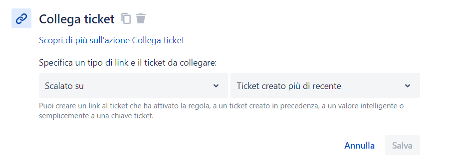

G. De Fazio October 20, 2023
issue link
October 20, 2023
Thank you...Would you please show the details of the issue create action?  There seems to something the create is doing which is related to issue linking.
October 20, 2023
In automation rules, things which happen at different points may not be visible later.  For example, when a variable is created inside of a branch or condition.  This is known as rule scope.
You appear to be using an if/else condition structure, and inside of that creating a variable named Progetto (i.e., Project).
That is also the name of an existing smart value for the issue, and so the rule could be encountering a problem: referencing the re-use of that term, referencing whatever value you are setting into it, and in the scoping .
It is generally a good idea to always name created variables so they cannot collide with other names, such as with a prefix like varProgetto.
Let's try this: rename your variable so it will not collide AND add a write to the audit log with the value immediately before the second if/else condition (where the task is created).  I believe this will show the value is empty.
Like • 2 people like this
G. De Fazio October 23, 2023
Solved!
- I collapsed the 2 "if" in 1
- I moved the issue creation in the same if
and now it worked!
