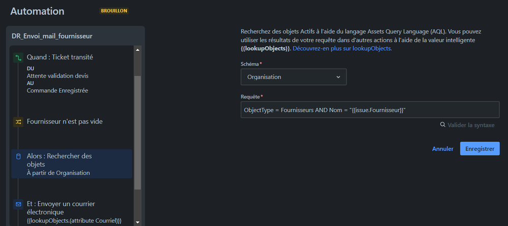

First the AQL request in lookupObject can't find the object :
And second problem if I replace "{{issue.Fournisseur}}" by "Toto" (the value in the customfield Fournisseur). The object is found but Automation failed to get the value of the attribute "Courriel".

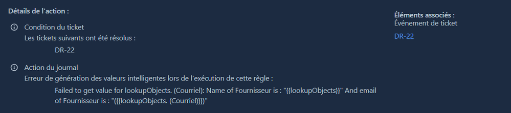

Here is the log :

As you said I add some log actions and it seems that the lookupObjects doesn't work, there is no value

Thank you @Tom Lister with the help of the audit log I was able to resolve each problem one by one.
So the good AQL was :
ObjectType=Fournisseurs AND Nom = "{{issue.customfield_10161.label}}"
And the proper way to call the attribute of my object was :
{{lookupObjects.Courriel}}
Everything is working fine now.
