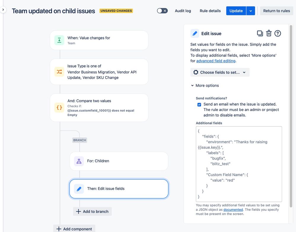

Claudia Dimick February 25, 2025
Hi Bill, here is the full complete rule. Atlassian Support cannot help me with this as they do not do consultative support, unfortunately.
