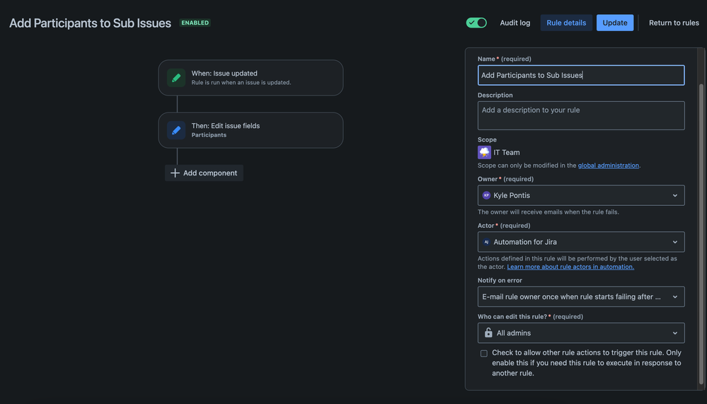

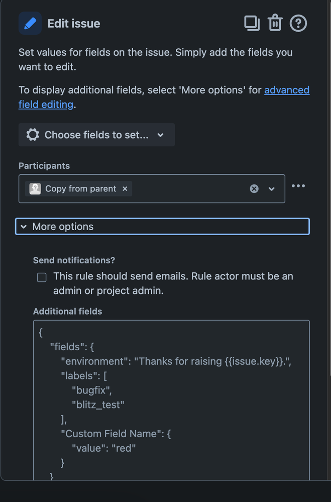

Hi Aaron,
Thanks for your help. I have attached images of the automation and its rules. Let me know what you think!
Hi @Kyle Pontis
Can you share a screenshot of the whole automation, please?

Maybe permissions? who is the actor of the automation? is it Jira automation?
Regards
Aaron
Sorry, I should have replied to your specific comment. I did reply on the main post however!
The automation is not even firing, so there is nothing in the audit log to present, unfortunately.
Jira automation is indeed set as the actor.
I have tried adjusting the automation so that the actor is me, still no luck.
