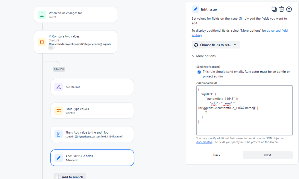

Hello everyone,
Could someone help me with this one ?
I'm trying to update a custom multi group picker from a custon single group picker.
Currently I'm trying this one :
{ "update": {
"customfield_11646": [{ "add": { "name": "{{triggerissue.customfield_11647.name}}" }
It works great if I hard code the group name :
[{ "add": { "name": "my-group-name" }
But I need this one to be dynamic.
I also tried to display my  {{triggerissue.customfield_11647.name}} in a log work, but it reamains empty.2024-10-10_16h14_35.png
Thank you,
Nicolas

Hi Nicolas,
I just used the actual field names and it worked fine.
"update": {
"Approver groups": [{
"add": { "name": "{{triggerIssue.Group Single Picker}}" }
Remember also that the smart values are case sensitive so it is triggerIssue and not triggerissue. Not sure if that was the difference or not.

Hi @Nicolas Rigaill
Try to replace the name with value
As you are now referencing the CF field name and not the value set in the field
Nicolas Rigaill
October 10, 2024 edited
Hi @Marc - Devoteam ,
Do you talk about this "name" ?
"update": {
"add": { "name": "{{triggerissue.customfield_11647.value}}" }
If so, it doesn't work either :(
Marc - Devoteam
October 12, 2024
Hi @Nicolas Rigaill
Does the log action on {{triggerissue.customfield_11647.value}} and or {{triggerissue.customfield_11647.name}}
Can you does this for the Branch, does this give a result?
