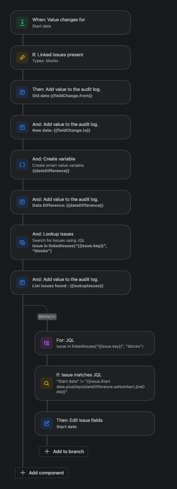

I'm trying to create, where if I change the start date of an issue for the issue linked, it should change the start date with the same number of days than the parent link.
I figured out a way to create a variable where it calculates the number of days that has change (minus or plus).
Everything is showing correctly in the audit log, if I change the start date for 3 days if show "3", I also have a "SUCCESS" showing, but the start date on the linked issues is being emptied ...
Here is the automation :
And here is the value inside my edit field start date (customfield_id = start date)
{{issue.customfield_10083.plusDays(dateDifference).jiraDate}}
I'm not sure where it blocks and why the field is being emptied ... If anyone has an idea on this !

Here is the final automation :
When value changes for : Start Date
If Linked issues present Types : blocks
Add value to audit log : Old date {{fieldChange.from}}
Add value to the audit log : New date: {{fieldChange.to}}
Then create variable create smart variable : variable name : dateDifference
Smart value* name : {{fieldChange.to.toDate.diff(fieldChange.from.toDate).days}}
Add value to the audit log : Date Difference: {{dateDifference}}
Lookup issue : Search for issue using jQL : issue in linkedIssues("{{issue.key}}", "blocks")
Add value to the audit log : List issues found : {{lookupIssues}}
Create a branch For : JQL
JQL : issue in linkedIssues("{{issue.key}}", "blocks")
Then Edit issue fields Start date : {{issue.Startdate.plusDays(dateDifference.asNumber).jiraDate}}
February 11, 2025
The 10 loop limit applies when the rule self-triggers due to updates (or triggers other rules).  That is, if this rule changes the Start Date in an issue leads to this triggering  the rule again.
That 10 loop count is from the service limits, and there is no way to bypass it with self-triggering rules.
The risky workaround I described earlier is only for 2-3 levels of issues and flows like this:
  1. From the trigger issue, identify its linked issues from the smart value {{issue.issuelinks}}, filtering as needed (or do that with Lookup Issues and JQL).  Save the list of issues in a Created Variable.
  2. Use the above issue list to build a dynamic JQL expression to find their own linked issues, again with JQL and the Lookup Issues action.  Save this new issues list in another variable.
  3. Merge the issue lists from #1 and #2 to create a combined, dynamic JQL statement, and branch over that JQL to make the updates.  This has an upper limit of 100 issues, but could encounter the maximum processing time limit and halt running.
