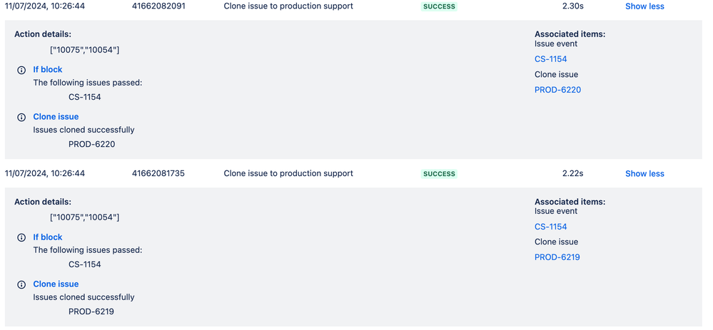

Here is an image of the audit log within the ruleScreenshot 2024-11-08 at 11.13.29.png
It appears that, for some reason, the rule is being triggered not only on transition but also on creation, which shouldn’t be happening and I don't know how to avoid this from happening.
November 8, 2024
Thanks for that information and I just recreated the symptom.  I found this open defect for the symptom: https://jira.atlassian.com/browse/AUTO-916
I hypothesize the root cause is in the updated REST API endpoint for issue create as it may be raising the event twice: once on create and once on transition.  Worse still for your scenario, the cloning adds linking (which is another slow operation) and so passes the condition due to rule timing problems between the two rule triggerings.

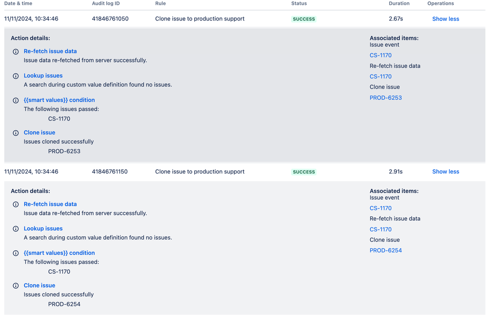

Alex Dokhtiar November 11, 2024
Hi @Bill Sheboy ,
Unfortunately, it still doesn't work as expected and duplicates are created.
Looks like there is no workaround. Anyway, thank you for the help!
November 11, 2024
Okay, let's go "brute force" to solve this: two rules, one for create transitions, and one for non-create transitions.
1) Create a rule, triggered on Issue Created, and check the status with a condition.  Then check existence and perform the clone.
2) To fix the rule triggered on Issue Transitioned, let's return to your original rule with these adjustments:
  • trigger: issue transitioned
  • action: re-fetch issue
  • smart value condition: This will check if the issue was created more than 1 minute ago.
    • first value: {{issue.created.diff(now).minutes}}
    • condition: greater than
    • second value: 1
  • JQL condition to check the clone does not exist
  • action: clone the issue
You may adjust that 1 minute to meet your needs / risk tolerance.  (For example, if there is an Atlassian automation outage and all rules stop running, theoretically the problem could still happen when the rules try to "catch up" running later.)
