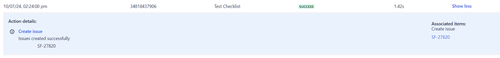

This is the audit log of the Automation:
I am using Create issue in this automation. Also I made sure the field "Checklist Text" is available on all three screens (Create, Edit, View).
I had it only in the Creation screen before, but in that case it just looks like nothing would happen regarding the automation, as the field can't be seen in the view/edit mode.
