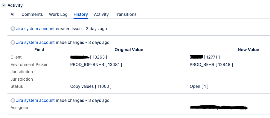

And the interesting find in the issue history that you proposed to check - it looks like the task created originally did contain the correct values, but they got overwritten somehow with the wrong ones:
Now I have to check all the rules and the workflow to see what is causing this kind of behavior. In the past we had similar rules running at the same time before and without issues, so something else changed and I have to find out what (there are other admins, who are also making changes). Thank you again for your directions.

Until the histories show more information about rules changing issues, you can try this:
Hover over the issue history to get the date/time of the changes, and then view the global automation audit log for that date/time.  That may help narrow down if a rule is making this change, and which one is doing it.

Thank you for pointers, at the end the automation rule had wrong epic linked to them and some workflow rule copied the values from the wrong parent - your suggestion to check the history tab helped troubleshoot this behavior.
