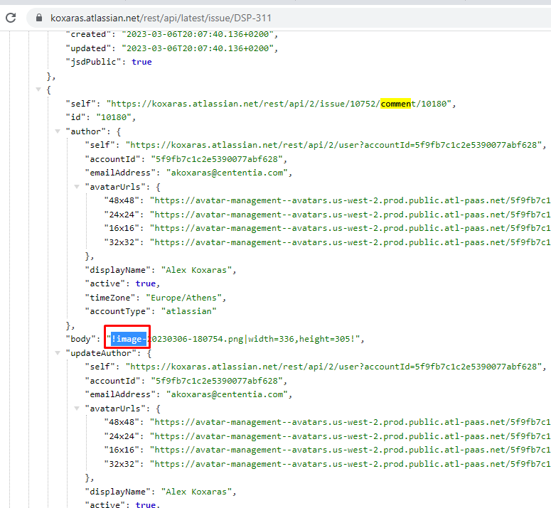

Searching for the comment containing the string !image- is equivalent of searching for an image within a comment. The response of an issue as JSON returns the following:
I've tested it and it works if I paste just a single image. This rule will run even if you paste a image and write some stuff. Meaning you have to be very careful with it.
Imo, I wouldn't use it and I would stick to manually transition the issue, OR find another business requirement with which I could automate the procedure.
